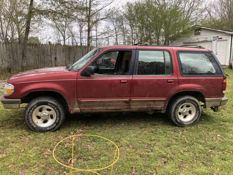

So I’m finally back on my feet and can take on a new project: MUTINEER II. Though I havent really settled on a name for it yet. Starting with a 1997 Explorer 4x4 with the 4.0L for the Drivetrain donor. The Body Donor is a white 1996 Explorer 4X2 with a blown 4.0L. Been awhile but it reminds me a lot of the Mutineer. See ya in the threads.

LOL the truck is a 2 owner. Have all the original papers from the first owner all the way to last year, when he sold it to his grandson. I saw pictures of it the day he sold it... it looked great. So 8 months in the hands of the grandson were ROUGH ones. Last time he drove it he had it up to the frame in mud, and they tore off the hitch trying to get it out.
It’s got 153000 miles, runs and drives perfectly and has no check engine lights. I can work with the rest.
