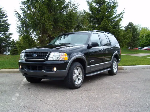

these are pictures of my install on my 02 explorer.

very nice especially since it is a twin to my 2002...
