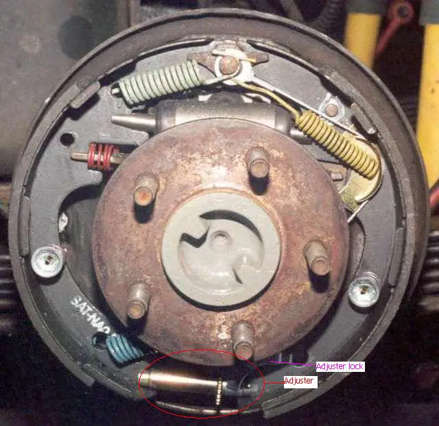

This would be a good time to learn your brakes. To adjust just remove the rubber plug on the back side of the backing plate and stick a screwdriver into the hole. Find the star part of the adjuster and try to turn it. If all is right, you will only be able to turn it one way- tighter. Keep putting more clicks tighter until the brakes just slightly drag while turning the wheel.
You can remove the rear wheels and brake drums. If the drum is hard to remove then chances are the shoes are adjusted out properly, but you may have to back adjust them off a little to remove the drum. Turn the adjuster the opposite way while pushing another screwdriver against a locking tab inside the brakes.
When you get to the brakes them selves you will see a mess of springs and two big friction shoes on either side of them. At the bottom of this mess of parts is a tube about 2 inches long, with a toothed star on the end. This is the adjuster. It is two parts; one screws into the other. See if you can turn the star part of it with reletive ease. It may need to be removed, cleaned and the threads anti-siezed.
Try not to take anything apart if you are not sure about drum brakes. There are special tools to use when working on them. You can use screwdrivers on the springs but its dangerous, especially if you have never done this before.
Picture courtesy the forum: (they never are this clean!!)
