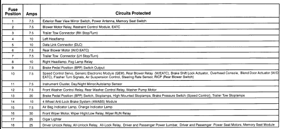

I was driving along & my truck's headlights went out....I have no daytime running lights, no brights, or dims. Also, I cannot find my owners manual to find out what fuses go with what....Typical female, right?! I just need help please!!! I cannot drive my truck with no lights. :(
in the engine compartment it is the second large fuse going up.on the left side. 20 amp's. large one.
onmy '99
I think in some of the later second Gens...they had seperate fuses for each side...I am guessing the switch might be toast.....does the flash to pass work?

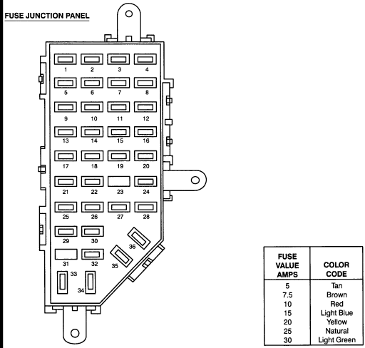

interior fuse box
Fuses # 3, 4, 8, 9, 11, and 33 could all have an affect on the headlights.
power distribution box (under the hood, up from the battery)
Fuses # 4 and 8 have to do with the headlight circuit.
