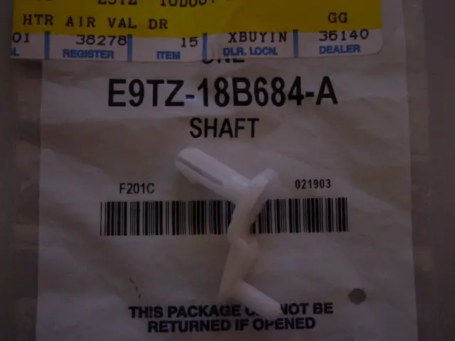

Guy's great news i can order the part here in AUS for $4.50 the shaft that brakes off right!!! So you won't need to pay $300.00 + for a whole new plenum chamber or have to rip out the whole dash. It's this easy dissconnect your battery, then pull out your glove box and passenger air bag, pull out the blend door motor and take the shaft off it then replace with this new one. I hope it really is that easy i will be doing it this weekend so i'll let you know then.
Could be wrong!! But I think that part fits into the part that breaks?? I was shown my old plenum and the broken part looked nothing like that. It was a while ago so....
