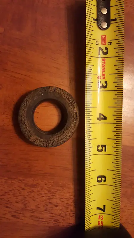

Picked up a new pump and relay and will install them tomorrow. I forgot to get the fuel filter part number before I left so I will get it tomorrow. However I am having a hard time finding one part for my fuel tank. It is a rubber grommet that goes into the top of the tank. the check valve breather thing goes into it with a line running to the charcoal canister I believe. See the attached pictures. Anyone have an idea on a part number on it. The truck is a 93 but the tank is out of a bronco II if that makes a difference.

Installed the new pump, relay and filter, took the truck for a drive and no problems.:) Roughly the same temps outside as yesterday as well. Hopefully my problems are solved. Over the next few months as I get chances to drive the truck hopefully this issue doesn't come back. I sure would like to find that grommet if anyone has any ideas on what it is called or a part number for it.
i worked on my friends 85 f-150 the other day and replaced all the fuel lines to the front tank. he couldn't fill the tank because it would spit back at him. found out whoever worked on the truck before didn't put the vent hose inside the big hose and used fuel injection hose for the fuel line. put regular 3/8 fuel line up to the switch and 1/2 in line inside the big hose. the check valve up on top of the tank was leaking as well and we got the part at the ford dealer for about 8 dollars, just took in the old part and they matched it up no problem.

dealer item, take old one with you costs about 10 bucks.
