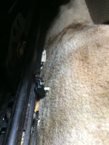

2008 Mounty Premier. Currently doing a pre-sale cleaning and came across this. Its on the front passenger seat, next to the console. It appears to be a limit switch, with one broken connector. The seat works as designed, and travels the full distance. The switch is loose, and is connected to the white connector just behind it. No other indications on the dash or from OBDII. Any ideas what this might be?
That's a seat travel sensor for pass airbag. It senses if the track is really far forward it disables the airbag.
Do you have any idea where its supposed to go? Its just dangling right there.
