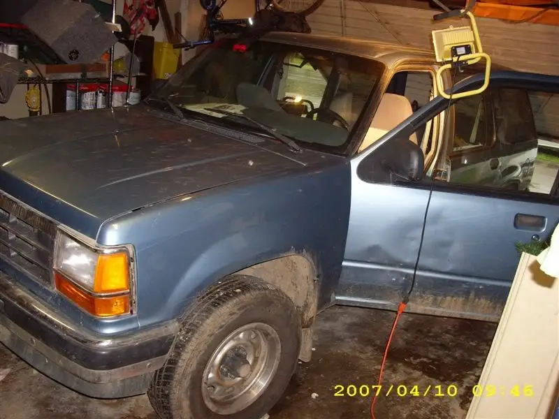

I picked up this stock 91 4.0 Explorer for 500 bux...
I also had some parts laying around and started thinking about what i could salvage.
So far iv come up with this....
I'v xfered my the 3" body lift off a b3000
I have removed the front bench seat and I am installing 2x Leather Bucket seats and a CUSTOM (diamond plate? ideas?)CENTER CONSOLE W/ 15" TOUCHSCREEN CAR PC (Mp3, GPS, Videos, Wifi, Maby OBD-I interface S/W)
Im in the process of slapping the front end off the 94 B3000 on the Explorer
I dont know if anybody has done this before... its a very close fit... i cant do the body work for a few months but i will mount it in the next couple days... Here i have it mostly in place...
I just need to figure out howto fit a ford emblem on the front :D/.... will prob just go without it.
I will need to weld an extension to the hood to close the gap on the bottom... and im not sure what im going to do with the gap between the B3000 Bumper and the b3000 grill clip... prob something custom.
My goal is to make the 91 explorer look like a second gen explorer for near almost free :)
Let me know what you all think.... if there is some interest i will take lots of pics...
I plan on using a heatgun to melt and form the plastic around the edge of the grill clip... then bondo to clean it up.... do you all think this will work the best???
Last pic is of my power steering pump failure(its non functional)..... i am going to replace the power steering pump... looking at the picture is there any reason to believe its not powersteering pump failure? The ex has completly manual steering... so is my diagnosis correct?
