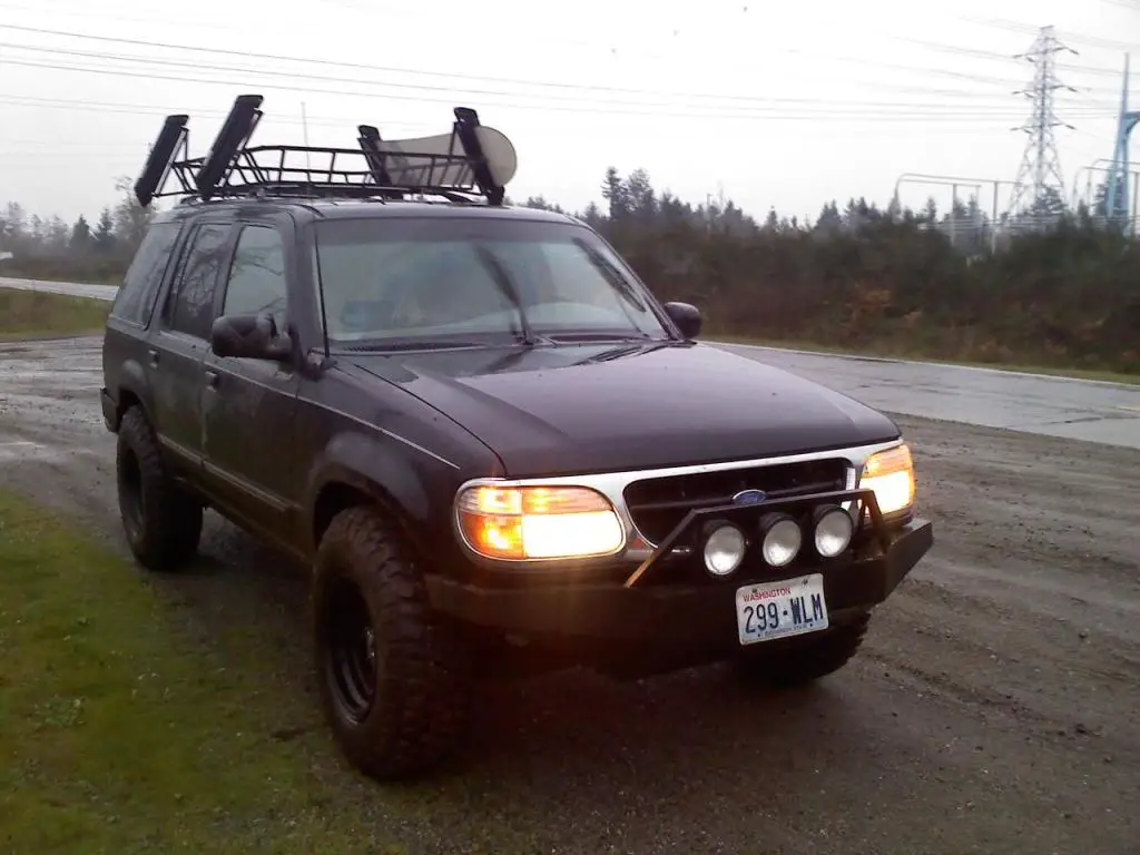

Hey all. I am new to the Explorer world and I have a few questions on what I want to do for the suspension system.
It’s a 2wd so I know its no crazy crawler but I want to be able play around in the mud and bounce over bumps with confidence.
I have some 265/75/16 BF Mud Terrains and I made some new high clearance bumpers and a rack.
My idea for the suspension was to mainly just increase the amount of ground clearance I can out of my suspension and maybe increase the strength of my suspension arms and joints. I figure there is no point in doing a body or a suspension lift only because I'll never be able to go in mud deep enough or up an incline steep enough to need it.
I was going to get some 3" torsion keys and max them, and add-a-leaf and a 1.25" shackle for the rear. Some descent replacement shocks.
I was going to get a full front end rebuild kit and I hear that there are some parts that are stronger then stock but you can get at the local Autoparts store. Does anyone know the name or what’s descent? I have a squeak, a little cluncking and some play in my steering rack, so I figure I should replace them now before I break something out in the middle of nowhere. Also I rub the top of my wheels on the upper frame rails so I'd like to add some bump stops. Are there some made for the explorer or some universial ones you guys like?
I am not a novice to cars by any means, just never worked on an Explorer or manly building something for off road. I can weld and do mechanics as well as fab on cars.
Anyways any help would be much appreciated.
Here’s a pic for good measure.
