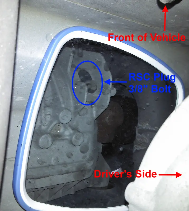

I have RSC on my vehicle but it doesn't seem to matter. Extra oil needs to be added regardless. Does anyone have a pic of the differential with these sensor plugs where you would add an extra 1 pint of oil?

Step one, get a mirror, this kind:
http://www.sears.com/craftsman-2-1-8-x-3-1-2-in-mirror/p-00904098000P?prdNo=2&blockNo=2&blockType=G2
or equivalent.
Remove the spare tire. Jacking up the rear is not necessary unless you need to in order to level the vehicle.
Use the mirror to look at the top of the diff near the front and off center towards the driver's side. You'll see a black rubber plug with a single bolt. Remove the bolt, then use a flathead screwdriver to assist in removing the plug. It has a seal around it so it might be a little tough to remove.
Using the mirror, insert a rubber hose into the hole going as far down as you can, that way it doesn't pull out while you're pumping. Pump in the extra pint. Remove the hose, reinsert the plug, tighten the bolt. The manual will have the torque spec but good luck getting a torque wrench in there.

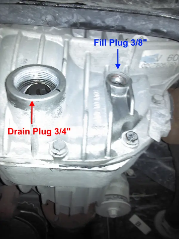

I just followed the procedure as outlined in the OP. The fill plug is 3/8" drive and the drain plug is 3/4" drive. I don't have a 3/4" drive wrench so I bought an adapter kit at Harbor Freight for $3.99. The 1/2" to 3/4" drive adapter is what I used for the drain plug.
I didn't jack up the vehicle. I followed iBrent's advice and removed the spare tire. This helps out greatly. There isn't very much room to put great force on the wrench to take out the plugs. I didn't have enough room to get my breaker bar in there primarily because the vehicle was not on a lift. Not only was the length of the breaker bar a problem but also when I put my 1/2" to 3/4" or 1/2" to 3/8" adapter on the breaker bar there wasn't enough clearance to stick the adapter into the plug hole. I ended up just using a 3/8" drive wrench for the fill hole and a 1/2" drive wrench with my 1/2" to 3/4" adapter then using a hard rubber mallet to beat on the handle. It took quite a bit of force to get those plugs to budge. It would appear that the factory used Loctite Red on the fill plug threads and pipe fitting putty on the drain plug threads.
I used about 3 turns of teflon tape when I put the plugs back. I did not torque the plugs as there isn't really any practical room to get a torque wrench in there. I pretty much just put them back very tight at approximately that same depth I found them at.
Adding the extra pint of gear oil through the sensor plug was rather easy. As iBrent suggested, a mirror goes a long way to locating and understanding what/where the sensor plug is. Because I had the spare tire out of the way I was able to get a huge hand mirror up in there. I took a picture. The mirror is above the differential so the image is a reflection off the mirror showing what the top of the differential looks like.
The small bolt holding the sensor plug in place is 3/8". There isn't much room to maneuver wrenches on top to the differential but I managed without too much difficulty. Pumping the extra pint of gear oil went smoothly. I used Amsoil 75W-140 SEVERE GEAR Synthetic Extreme Pressure (EP) Gear Lube. The plug is made of a composite plastic type material and there is a rubber O-ring around the stub that sits inside of the hole in the differential. Putting the plug back in place wasn't too difficult. I did not torque the small bolt but made sure it was tight.
