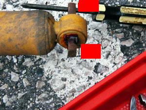

Here is a pic explaining how you would put a spacer over the bar pin. The red squares would be where you would stack the spacer (I've even seen washers used).
