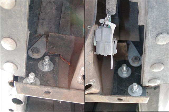

Rob...you got a pic of those rear brackets installed??

Here are my brackets installed (no, I'm not going to remove my rear bumper to take pictures of them uninstalled:)). The left picture is my left bracket, my right is my right. The two bottom bolts are where the bumper originally bolted on. You can see where I had to notch out the frame and the bottom of the bumper to clear.

robert i cannot get into that to see your picture
Nevermind i see it now.Thanks alot Brad in iowa

I meant to ask...what did you use to cut the frame and the bumper??
My die-grinder with a 1/16" cutting wheel and my air-compressor.
