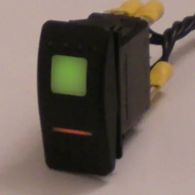

Here is what I have. I am building a panel to install in my truck that will have conrols for my winch. I have an on off switch to activate it and a (on) off (on) switch to control in and out. The switches I have have two LEDs in them. One light will be wired to the dash lights to turn on with them. The second light will turn on when the switch is turned on.
On the on-off SPST switch it works fine. On the (on)off (on) SPDT switch, I can get the dashlight working fine. However on the the light that only turns on when when the swithc is on. When I wire it to come on for the up postion it will also send power to the down position. Thus if I had it wired to the winch it would send power to both the in and out silinoids.
I went to radio shack and bought a small diode. I have it working right but it is kind of hack. Anyone know of a good way to wire a diode in.
Cliff notes. Need 2 switches to turn on one light without backfeeding the other switch,. Do not want it done hack.
Here is the switch.
That is basically what I have right now. A small cylinder with a silver wire coming out of each end. What would be the best way to attach it to some 16 ga stranded wire?
Here is what I used. Just wondering if there is a better style or the best way to wire it in.
If you're just going to put a diode by itself inline, cut the ends to like a quarter of an inch, solder the ends to the wiring and then heat-shrink wrap over the whole thing.
