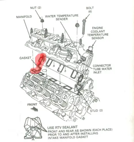

I would second the suspicion that you have an intake manifold gasket leak at a water passage.... it is not an uncommon leak in the Explorer.... I'd check all plugs to see if you might localize it.
Ooh! I get to use my manifold leak picture. The car places also sell fluorescent stuff for coolant, but unless you got a visible leak somewhere, I'm not sure how much value it is. I've got a bottle I've never used.

I don't know why I didn't do this before. Last night I had my pressure tester hooked up to the hot engine, and wasn't seeing anything. While it was sitting, I thought, "I've heard of people finding "snot" under the oil cap. I wonder..." Took off the oil cap and, sure enough, there are a few "balls" of "snot". It looks like I know where the coolant is going now. So the next question is, which gasket is leaking? Intake manifold, cylinder head, cylinder head cracked (I sure hope not). Thoughts on isolating the leak? Or does one usually just stop diagnosing at this point and start tearing it apart.
