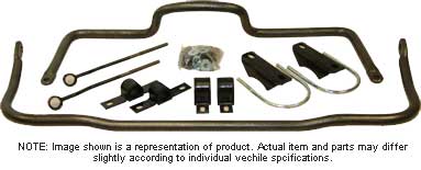

The U shaped bar at the bottom of the pic is a front sway bar. It is held on the frame by two brackets attached tto the frame in the middle and by long bolts on the ends. Noise sometimes comes from the rubber in the frame brackets (bushings) needing to be removed & greased.
Just lay on your back under the front and it will all be clear.
