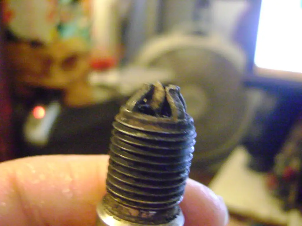

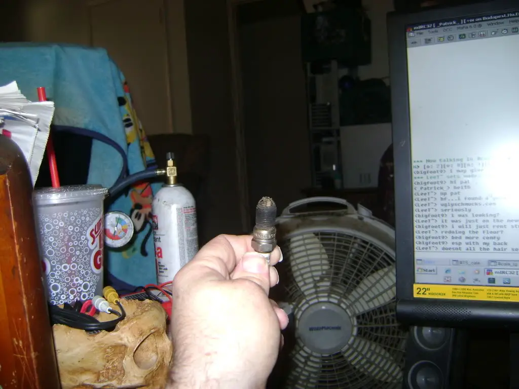

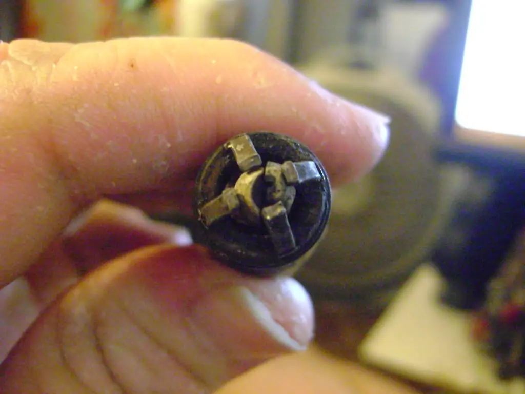

also here is a few pics of the spark plug i removed from the far back on the passenger side

really hope its none of thoes that are making my spark plug go bad like in the pic i provided...need to keep it going well at least till feb
Testing compression will tell you if you have mechanical problems. If you have bad compression, you then perform more tests to figure out what your problems are. My favorite method is compressed air into the cylinder, through the hole for the spark plug. You hear air coming from your crank case, you have bad rings, air in your intake or exhaust (assuming your cylinder is not on intake or exhaust strokes) you have bad valves or seats, air coming from your coolant, you have a bad head gasket, air coming from your valve covers, also bad head gasket.
Though, 99.99999999% of your problems is probably related to those bosch +4 plugs. They are the cause of problems in so many cars I see with those plugs in them, I can't believe people still buy them.

changed them with autolite platnum's, they were all burnt in some kind of degree's some had an orange/yellowish tinge to them one had some oil deposits on it, and then the one in #6 cyl, the electrode wasnt exploded like it useualy is, but it was broke cuz i shook the plug and it rattled

and #6 was the one with the broken electrode
