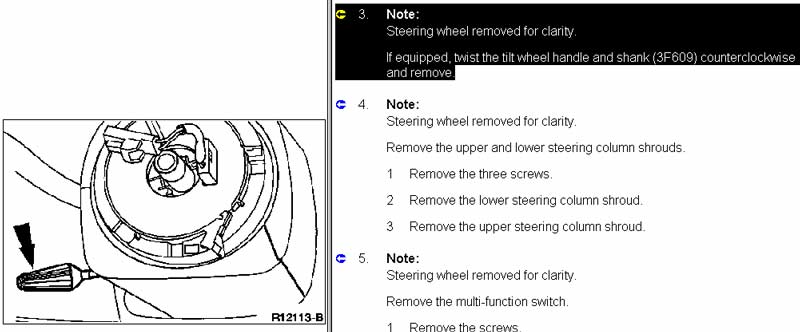

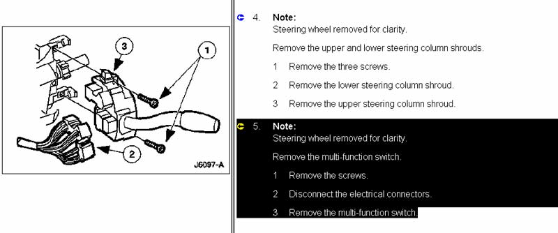

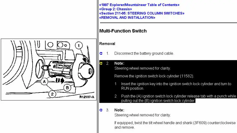

Hi, I have a 98 Explorer XLT 4WD and when I go to turn my lights on HIGH beam, they sometimes "short" out and I was reading the threads pertaining to this problem but could never find the actual instructions on how to install a new turn signal/multifunction switch.
Can someone please direct me in the right place or post them for me?
Thanks so much. Steph
I found this writeup . There is at least one other writeup on this, I found it a long time ago when I was going to do one. I will post the shop manual instructions also.
More
