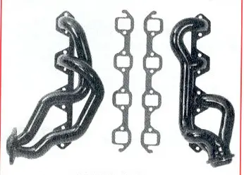

Does anyone have the part number for the Ford
Motorsport headers that fit a 1998 5.0 Explorer.
I know they are next to impossible to find , but just want to have the part # in case something ever turns up. Also if anyone has a picture of what they look like that would be great.
Thanks
Randy;)
M-9430-E50..... stainless
M-9430-E51..... stainless w/ceramic coat
note that they list for the 96 and some 97's only. to run on 98-up you need to have an EGR bung welded on.
