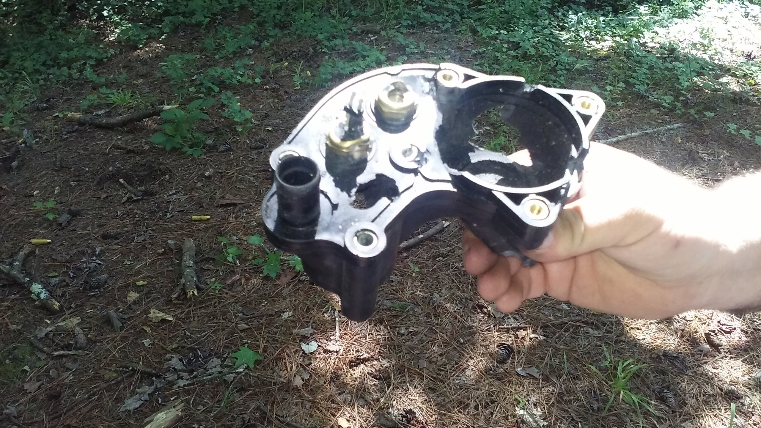

I still haven't changed the water pump because I wasn't entirely sure that's what was leaking. Since the radiator would never leak down to the water pump level, I figured it was coming from somewhere else but could never find it. Then on my way home one night last week, the engine had spiked to the upper end of the temp range and just as I pulled off the road the check gauge light came on, and it had blown coolant all over the top of the engine. I tore into it today, and found the thermostat housing nipple going to the heater core was broken off so I'm now looking for a replacement. I hope this was the lesser leak I had and it just got worse, athough not sure what would cause the nipple to break off. Anyone ever hear of this happening to anybody else?

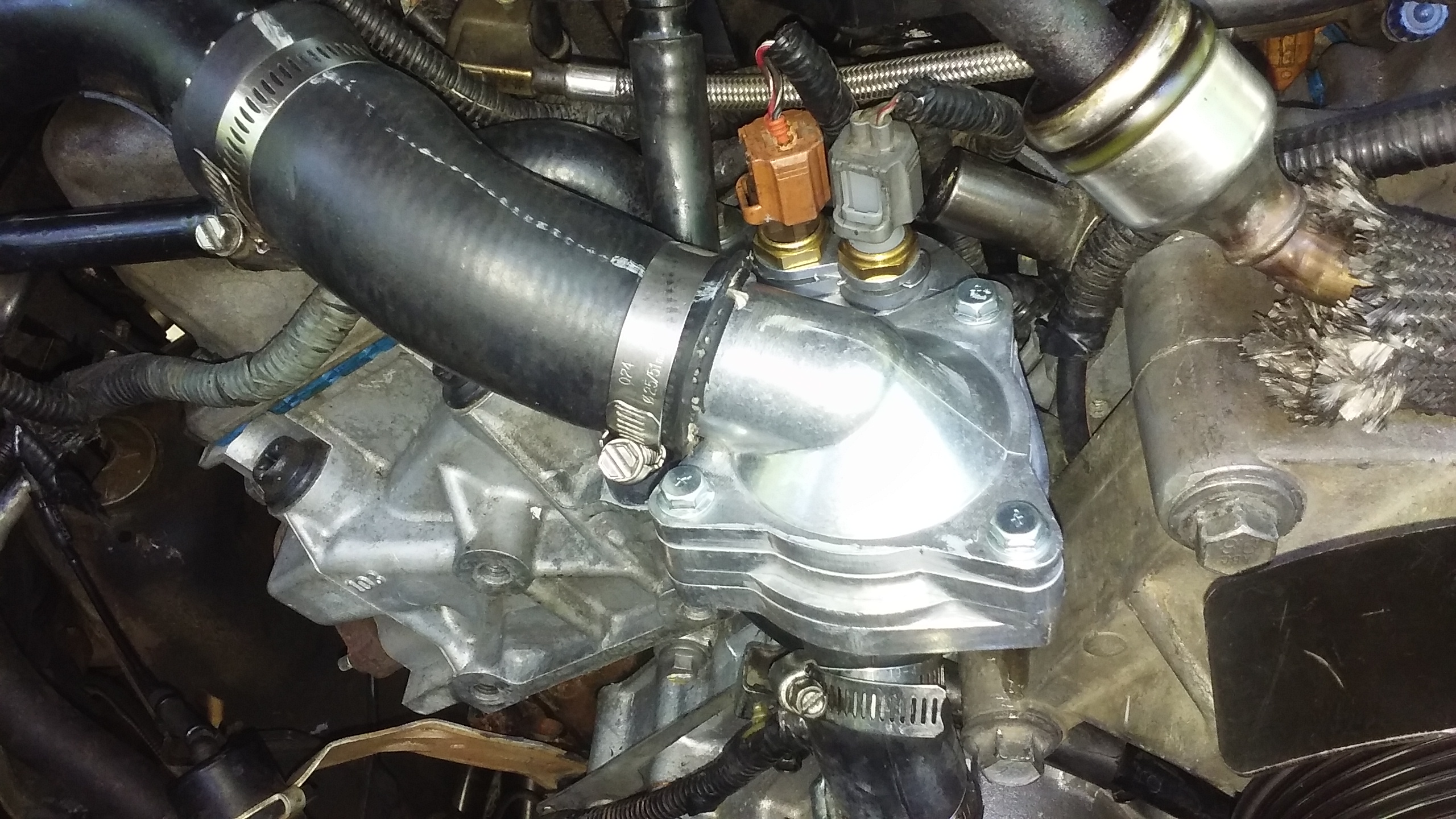

Does anyone know if an aluminum thermostat housing for 01 and up 4.0 SOHC will bolt up to a '98? If the only difference is that the neck points another direction, I can put my original plastic upper part on it.
Donalds, thanks for the info, I ordered one for the 01-11 Explorer and going to switch out the upper spout.
I can't wait to get the old Explorer back on the road, getting tired of driving (and parking) my F250....
UPDATE: I got the aluminum housing from eBay and it bolted right up, but I did have a little problem with the heater hose. The nipple was a little farther over and the existing hose would not reach so I had to put another one on it.
The ultimate failure of the original plastic housing was when the nipple for the heater hose broke off, and when I removed the broken piece from the hose it disintegrated in my hand. I've been running water in it for a week to verify there were no more leaks, and will replace with coolant today.
