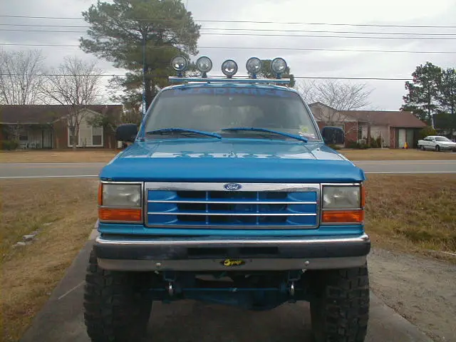

Has anyone had a problem with the front wheels toeing in after a 5.5 lift, mine are and the shop says its gonna be like $150 for the shims and realignment. if anyone has anysuggestions let me know. also I dont have the extended radius arms yet. thanks mike:confused: you can kind of see it here.

I get it aligned and its fine, but the first time I go wheelin its back to all toed in. I don't know what it is but if anyone has an idea to fix it for good then I'm up for suggestions.

Thanks cory, I have a camber prob, I looked on top where the upper ball joint is and there is an adjuster on there but have to get the right socket to turn it , its a 12 star i think, anyway do you think that if i put some 1 1/4" coil spacers in it would drop back to normal, I have had the lift on since november and it has been getting worse since january.when I lift up on the bumper they go back to normal. thanks, mike

well just got off the phone with the superlift tech, and apparently the 118 coil springs that I got from 4wparts is too weak for my application , explorer with 5.5, he said the motor and truck was too heavy, so being the cool guy he was , he is sending me a new set of the 133 coils for free and free shipping to send my old ones back. just thought I would let you all know , in case you had the same problem. my coils were only on since nov and already crapped out. later:confused: :confused: :confused:
got the 133's on last night, now they are just the opposite, the top of the tires are out farther than the bottoms and when I tried to go over 20 mph the steering wheel freaked out from side to side, anyone have any suggestions. do i need the adjusters????? help.:bounce:
sound like you need an alignment know, should just need a regular one with no additions. The new coils are more than likely taller than the old sagging coils therefore throwing the alignment off!
Ya I finally got my hands on a 12mm twelve pt deep socket and adjusted the factory camber adjustments, they are damn neer perfect and had to align it again, she is running straight again, and didnt even have to get the bushings from superlift. I do however need to get the longer radius arms to fix the castor, I have a friend who is working on a prototype crossmember that incorporates the radius arms mounting to it, it is very beefy looking. I have some new custom shackles being made to lift the back to be even with the new springs. I'm currently working on the front end putting my front reciever for my winch on and working on the back, kind of sucks with the body lift , we have to mod alot. later.:D :confused: :confused:
