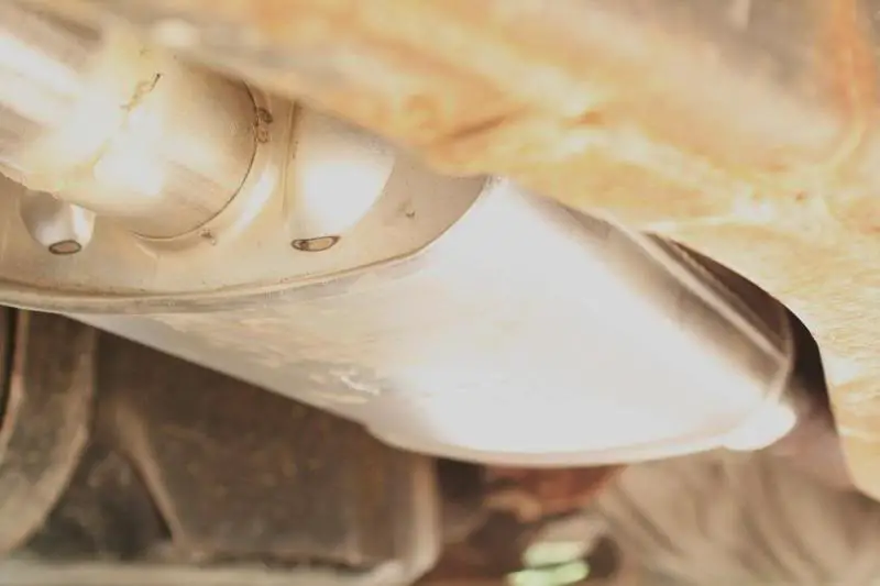

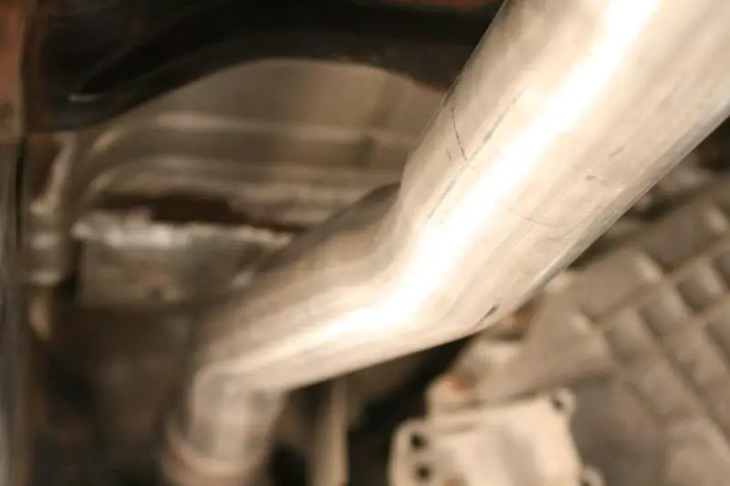

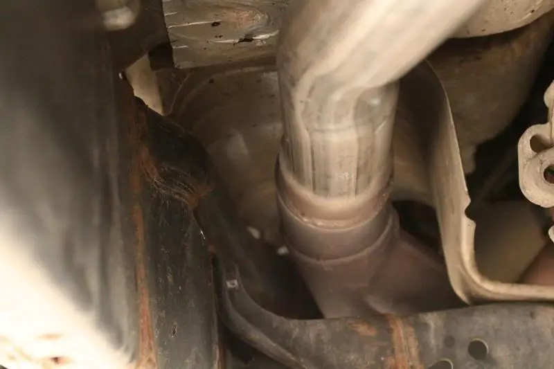

Mom and Pop shop cut the third *kitty* off and expanded some 2.5" and custom bent a new midpipe to a DynoMax Super Turbo 17733 2.5" muffler. The muffler was then reduced and the stock tailpipe was retained. All connections were welded and painted and a new hanger was installed in the stock location on the midpipe. Pics are here
http://s3.photobucket.com/albums/y74/DCopp/Mountaineer Exhaust/
I can take more if any are requested. I chose the Dynomax due to its quiet nature and it is only audible when accelerating. It is near stock silent when cruising in 5th gear. MPG improved .3 on the way home (7 miles) from the shop. I am hoping to gain 1.5+ MPG by ditching the cat and long restrictive muffler. I'll keep you guys posted. And I will try to get a sound clip somehow too. All I have is the wife's high dollar Canon camera as our small digicam got lifted on our trip to Mexico...
