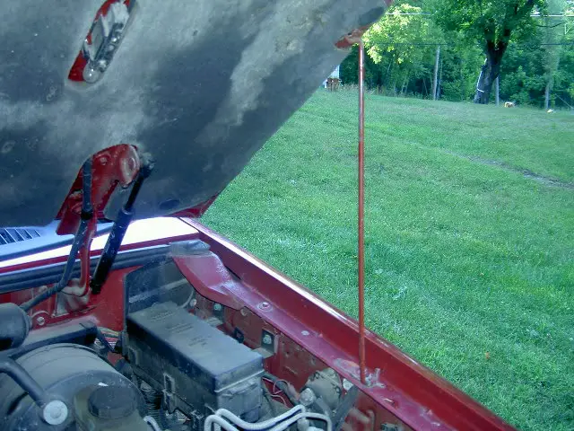

After replacing my struts two times and then having my hood again come crashing down on my allready screwed-up neck....this is how I fixed it. I must warn you this is not for the faint hearted.
The cost of the rod $1.00 Junk yard
Labor Free I did it myself
Not ever again having it smash me Priceless

Great Idea rookie:)
