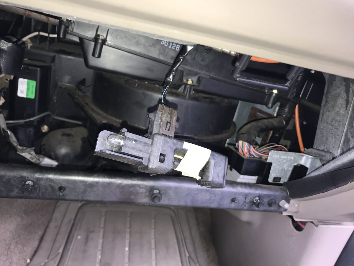

Can somebody tell me where the glove box lamp is supposed to mount? Mine is hanging free and I can’t figure it out:

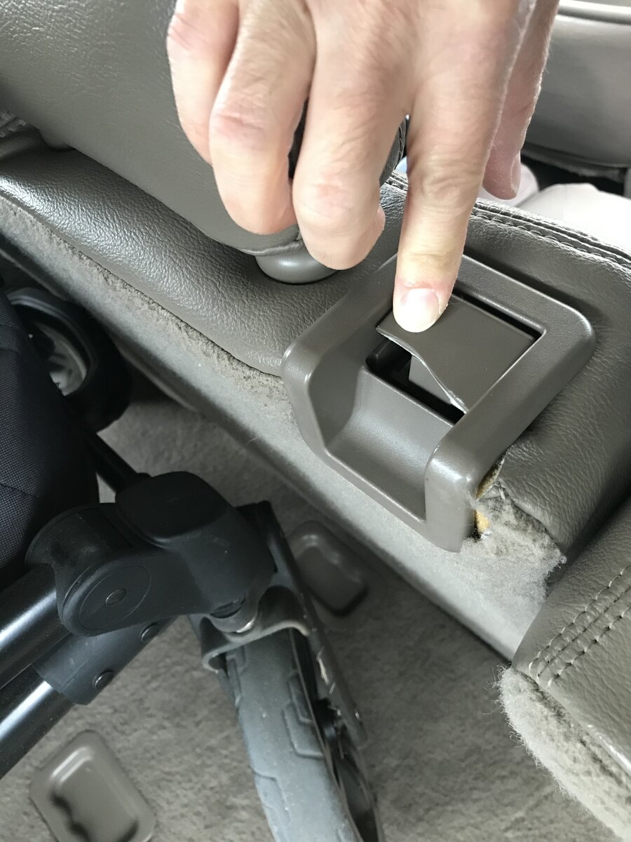

Also, 2nd row middle seat release lever is busted. I’m assuming this is common. Is there a known hack or fix for this? I’m assuming the lever assembly is not available separate from the seat:

Well, I’d still really like some info on where the glove box light mounts, if somebody can post a pic that would be great.
And anybody else have a busted second row middle seat release lever? And if so what did you do about it?
