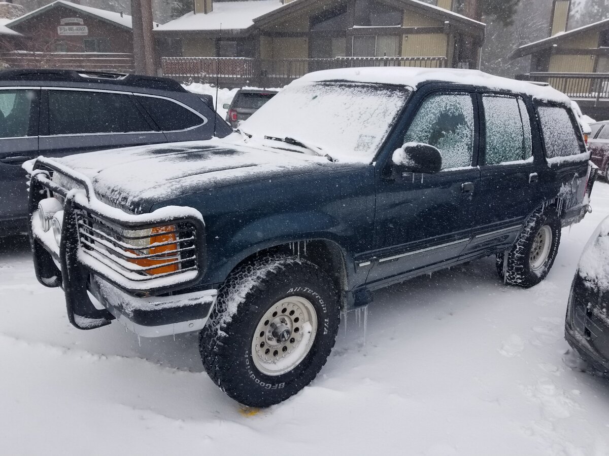

Sounds like a nice rig. Do you have any pictures?
Take care and be safe.
This was a morning after picture in February 2019 at Big Bear Lake in California. Went for snowboarding and had a really fun time!!!
Nice!!!
