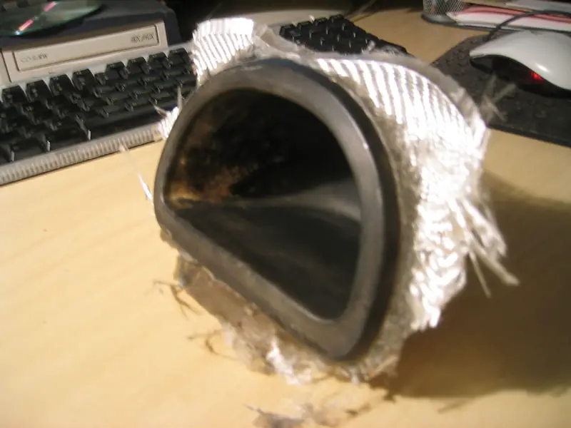

Not really much of a write-up. It's a fiberglass step that I formed over a silicone plug I made. (picture of a rough one below.) I got the idea from old pick-up trucks that I had seen with aluminum steps inserted in the side. I've also seen then on RV's for the driver's door. But they were too big. I couldn't find any of the small ones at the pick and pull so I made my own. Then I cut a hole in the body to accept it. This one was sprayed with a textured paint to prevent slipping. I also want to install one on either side above and in front of the rear wheel well at the same height as the back door handles. Then I can stand on the tire and then the step to manage the loads on the roof.
