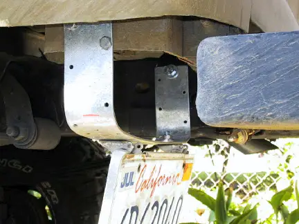

After installing my new low profile, high clearance, rear bumper, I needed a way to mount my license plate. I cruised around for a couple weeks with ty-wire holding it on till I rounded up the parts. I went to the junkyard and got a fold-down rear plate hinge/holder off a 80something Camaro for $3.00, and a building strap at Home Depot for $3.00, a couple bolts, and came up with this!
