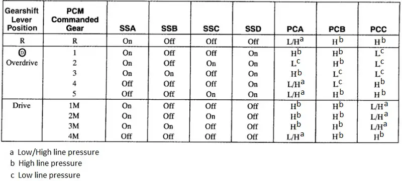

Sorry for the delay. Code is P0775 "Pressure Control Solenoid B". These solenoids are electronically controlled, correct? The reason I am asking is because I believe there is a small vacuum leak somewhere (fluctuating idle when below operating temp). I don't know enough and have not found any clear answer as to whether or not a vacuum leak could cause a solenoid to misbehave.

logic table
"pressure solenoid B" is PCB in the table. A vacuum leak cannot affect the solenoids. However, a serious engine misfire problem could cause the PCM to enter "limp mode" in which the O/D light should flash. Are there any engine related DTCs?
