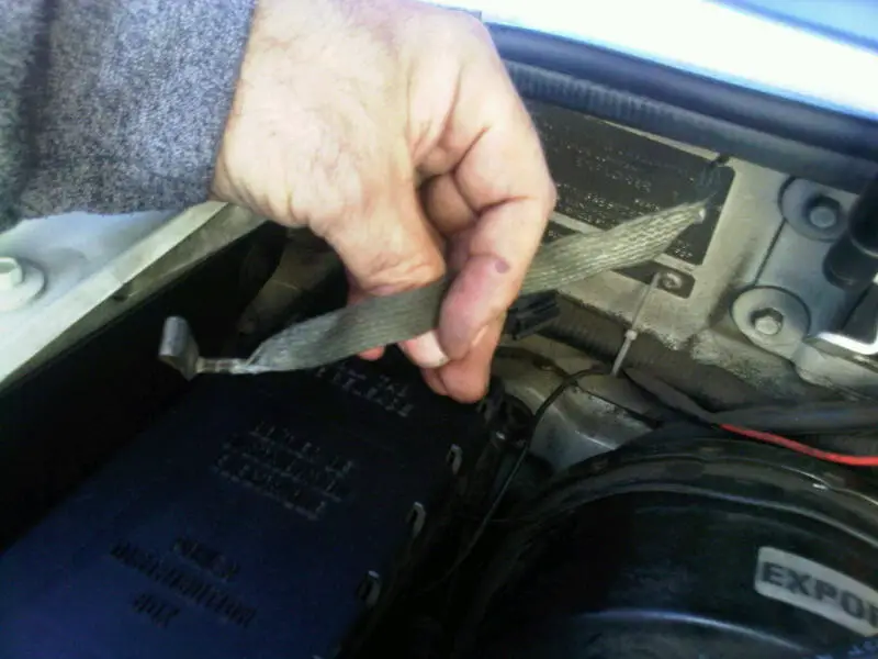

I cleared the overdrive light flashing with my scanner, be interesting to see if it comes back...under the hood I found the earth strap in the pic , does anyone know where its meant to attach to?
Hood, based on its placement.
ah ok, thanks, Ill look at that :-)
