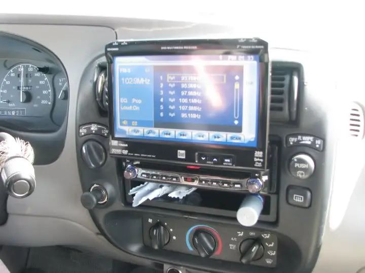

I put in my new Dual Stereo system in my 1998 Ford Explorer and everything works on it except the sound. I put the old stock back in it to see if I hooked something up wrong. But, It worked just fine. Can somebody please give me a solution to this problem. I can't play Cd's in my stock radio, because of the laser quit working. The cd player just says CD error when you try to play a CD. So I got a Dual Stereo system, and now I can't even get sound. Please will someone help me I would appreciate it.

It lights up with no sound
Is this on both CD and radio? If it has radio sound, you used the wrong remote turn on wire. VERY easy mistake.
^^^ what he said.
on your harness there will be a black/white wire. this is the harness that plugs onto the factory harness. Ground it!!
