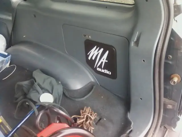

as for the factory amp... if your stock unit has "dnr" printed on the tape deck door, then you have a stinkin factory amp. what id suggest is just buying the amp bypass kit again from crutchfield. its like 10 bucks and it's well worth it. all you gotta do is get to your factory amp and plug in the harness. its right behind the trim piece on the passenger side cargo area..
thanks to Masterd, heres the amp
:thumbsup:
Thank you SO much. hahah. I was so lost. The only thing i need to know is what size speakers will fit in the front and back. and then im set.
