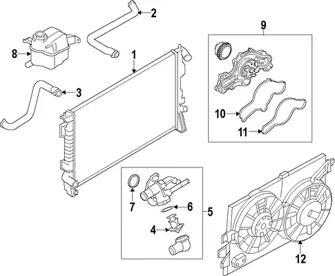

The water pump has a weep hole to drain if it starts to leak. The problem if I recall is more of a bearing issue with the pump.. if that goes, the pump starts to leak through into the engine. There is also an internal and external gasket and if the internal gasket goes, that is where it is suppose to leak (weep hole).
There have been some failures of these. Yes, poor design.. the reason it was designed this way is because of it being a FWD vehicle primarily. Because of that, the motor had to be turned 90 degrees and the motor would not fit with an external water pump. All FWD 3.5s have the internal pump.. all RWD 3.5s (like the F150) have an external water pump.
I don't believe Ford maliciously designed the motor like this knowing it would fail. I think they took the precautions that thought they needed too.. heck this engine is almost 10 years old now and there are not a ton of failures of them that caused motor failures BUT it is still a possibility.
Water pump #9 with internal and external gaskets #10 and #11
You could also ask the dealership to pressure test your coolant system. When I thought I had smelled coolant on mine, my dealership pressure tested it and it held pressure both times I requested it. If it starts to lose pressure, well you have an issue.
