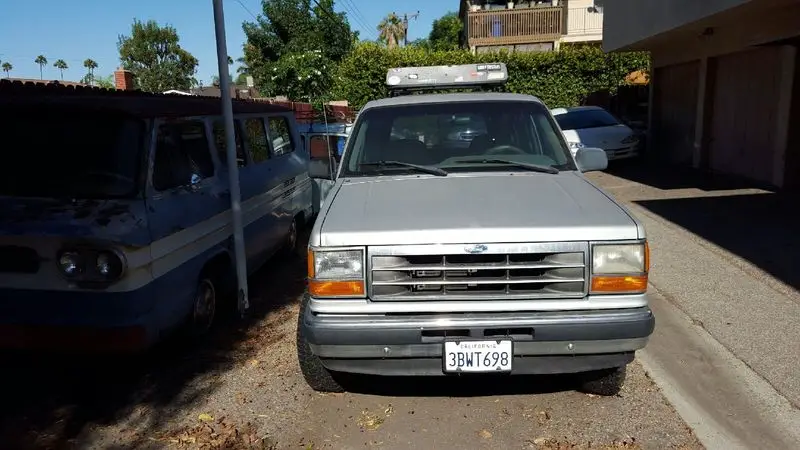

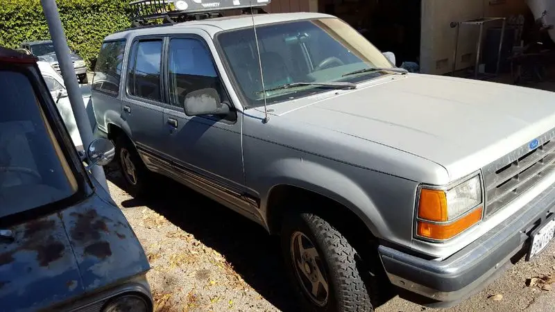

Well I am a Volvo guy and have been for 12 years now. Never owned a ford but free is free. Well my new toy as I still have two volvos. 78 242 track car and 94 940 also was a free car. So 91 explore xlt 4x4 86,000 miles on it. What's should I be looking for as of problems with these models. It had the transmission replaced with a used one. Seems to shift a little ruff and what not but still drives. Just going to use it for camping and little 4x4ing. One last thing I just need a simple budget lift to run say 31 a/t.

Welcome! Never seen that style of center cap before! 91 had a few odd wheel/hubcap options. 91 also had a few year-specific items such as the floor pan shape under the front seats and the dash bezel.
