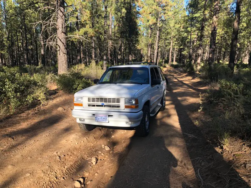

Hi All,
A few months back I purchased a really nice '93 Limited that had been sitting in a garage with minimal use for the last 10 years or so. Exterior and interior are in great shape for the age, ~135,000 miles on the clock. Had to replace tires and do some suspension work to replace rotted bushings, but she's up to speed now.... except suddenly she is dying on me and the problem seems to be getting worse.
On cold start the engine revs to 2,000 RPM or so for about 15 seconds, then drops super low (500rpm or so) and dies unless I tap the gas at which point it revs back up for another 15 seconds. When warm, the RPM seems to stabilize around 1,000 RPM. No check engine light is on. Engine doesn't feel like it is missing, shaking, or otherwise until the RPM drops too low. When put in gear it used to stay at appropriate RPMS, although recently it has started dying in gear as well. It does appear to be losing coolant slowly too. No evidence of it in the oil.
So far I've tried changing air filter, cleaning MAF, changing the IAC valve and PCV as some other threads suggested but with no change on behavior. I'm wondering about an intake manifold leak (might explain coolant loss?) - but didn't get any surging of the engine when spraying brake cleaner near the intake gaskets.
It's my extra car - so not in a rush, but would love suggestions on how to troubleshoot this further before I rip the intake apart as a blind guess. Thanks in advance!
Nice Limited!:thumbsup:
