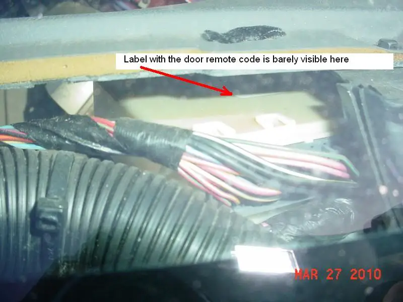

If it is a Job 1, its behind the centre of the rear seat. If its a Job 2, its under the defroster vent and the passenger side. Pop up the defroster panel and peek thru the windshield with a strong flashlight and look for a white modual about the size of a pack of smokes. The 5 digit code will be slightly larger the other data. Best to do when its dark outside.

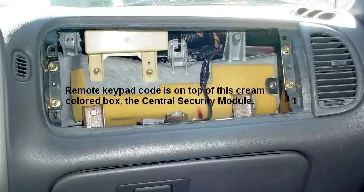

The door pad code is on top of the central security module, which is behind the passenger side air bag on a Job 2 2001 and on the back panel under the window on a Job 1 2001. Job 1 / Job 2 crossover date = June 24th, 2000 so you'll have to determine which you have from the date on the vehicle certification label on the door.
This JOB 1 JOB 2 thread will also illustrate the underhood visual differences.
THIS method is the easiest in locating the code on 2001 Job 2 and later models.
Alternate to this is depowering the SRS and removing the air bag.
