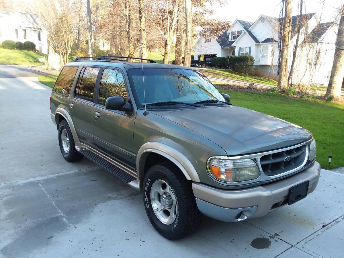

It's a 1999 Eddie Bauer 4x4 4.0 with only 61k miles on it. It was priced at $5,500 & only posted up for an hour on Craigslist before I contacted the guy. Told me it was his mothers & that when she wasn't able to drive anymore that it's been a second car for him and he just doesn't need it anymore.
Since the low mileage, i told him I'll take it for the asking price if he would hold it for me till this weekend. I'm guessing it seems like a good price. Paint seems good, looks like its the Sage Green color & he said it's always been under a carport so its in pretty decent shape for the age. Interior looks amazing from the pictures, practically new.

That top paint looks shot, I hope that's just a poor reflection.
The SOHC V6 is definitely to be avoided, those should sell dirt cheap given the issues(and people want/wish to swap the 302/4WD into them(lot of trouble)). That price would be fine if it was the 302, but not the V6 unless you were going to baby it and take great care of the engine.
