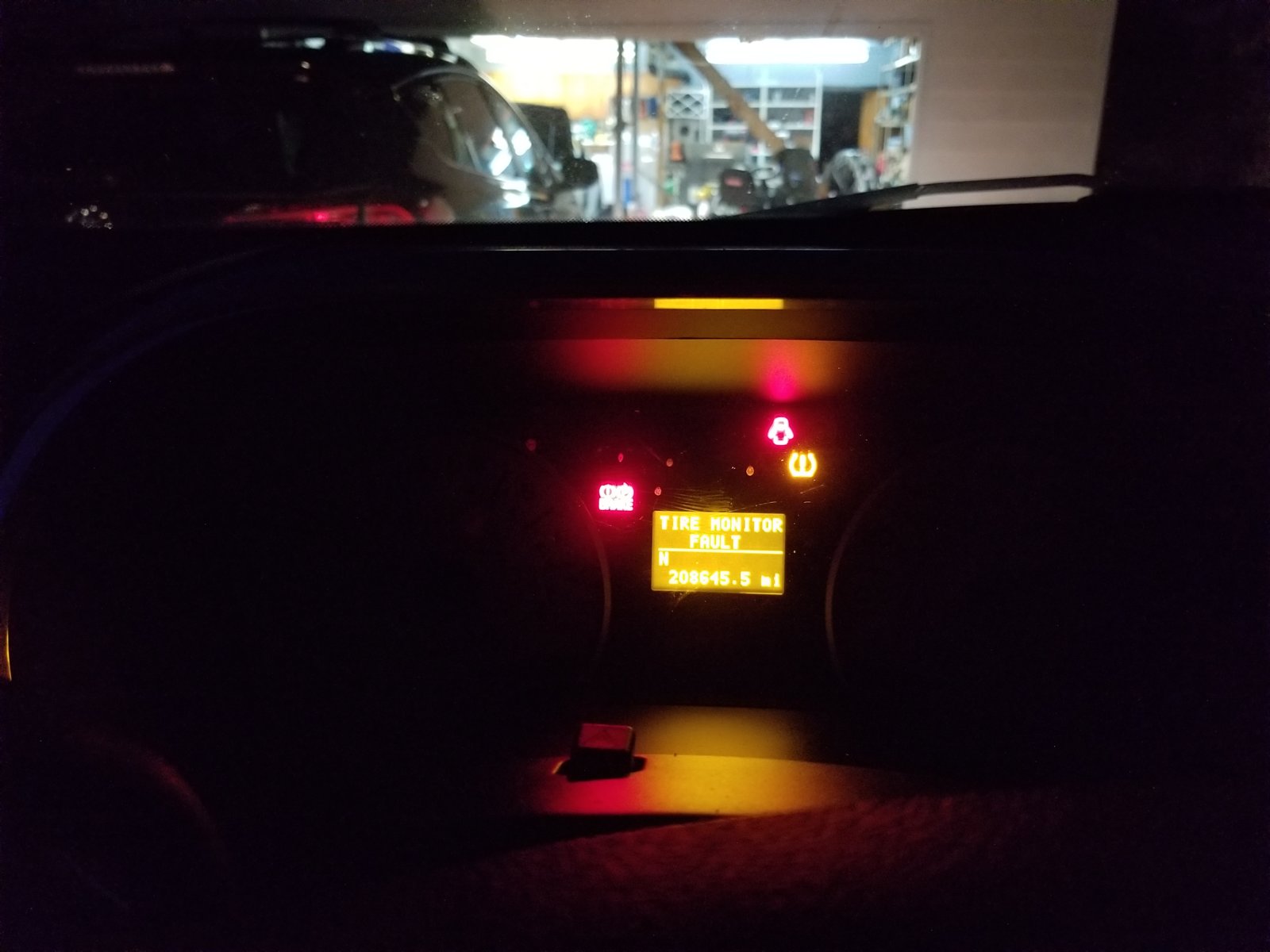

nothing aftermarket on it at all, completely stock. On the dimmer dial if I roll it all the way to the right and click it the dome lights come on. It is wierd that the open door light stays on as well. This pic is with the truck running and the headlights on
ok so I have more problems lol. Pretty sure the GEM went out.....anyone know how to remove it? Is it on top of the fuses in the drivers foot well?
You need to remove the dashboard to get the SJB (GEM) out. I'll be doing this myself in a couple weeks. I suspect I have a bad SJB, my puddle lamps don't work and my dash lights are stuck on a set dimming level. I've replaced the dimmer already. Codes stored in the SJB all point to replacement so that's what I'm doing. If you do this yourself you'll either need the Forscan software, or take it to the dealer and have them push your vehicle asbuilt configuration to the replacement SJB.
I've still got no lights behind my cluster, nor do the buttons on my radio light up. Turn signals dont show up inside the truck, but work on the outside as they should. I'm guessing it' the GEM module
Yeah I agree with that.. I found a replacement SJB for $50 shipped from a yard that I found on car-part.com. (Searched for 2006-2007, Fuse Box Cabin). If you go this route you can use one from a 2006 or 2007 as long as it wasn't a SportTrac.
