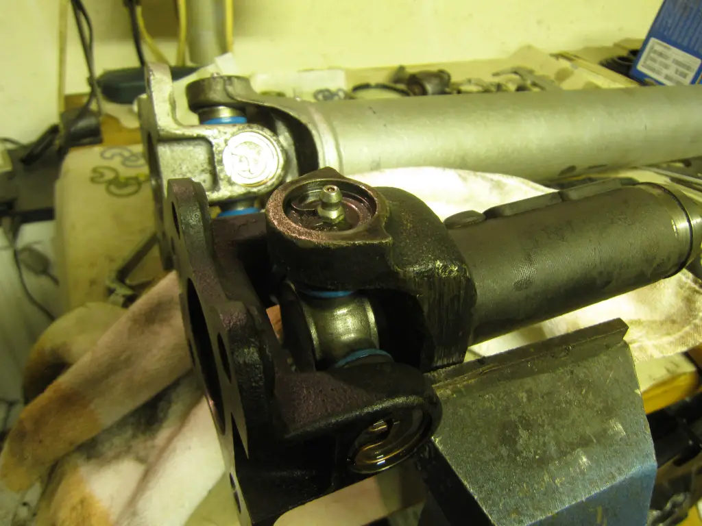

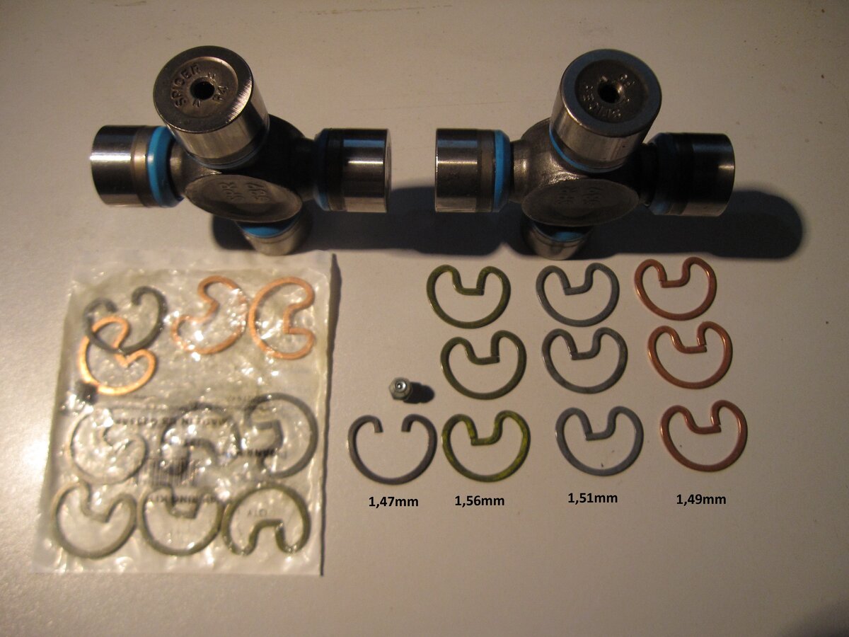

Now i ordered two new Spicer 5-1330-1X U-joints for the removed driveshaft , they came with different snaprings,
the copper colored snaprings should be the matching parts, they are the thinnest ones.
Installed the new u-joints with the copper snaprings, but the u-joints feel very stiff.
So i grind down the six copper snaprings to 1,45mm (0,057 inch) an the u-joints
feels much better now. But what's the best way of alignment for lasting a long time?
The u-joints should have no "preload", but should they have a little axial play?
How smooth should be their movement?
I'm looking forward to some opinions.
regards Wolfgang

if ya pry at em they should wiggle a tad bit not a whole lot
Yes, there should be a maximum axial play of 0.002 inch.
Spend the last two hours grinding the snaprings a little more down and pump
the u-joints full with grease. Now both u-joints are smooth and the dial indicator shows
0,0015 inch play.
For the future i ordered some Spicer 2-7-469 snaprings.

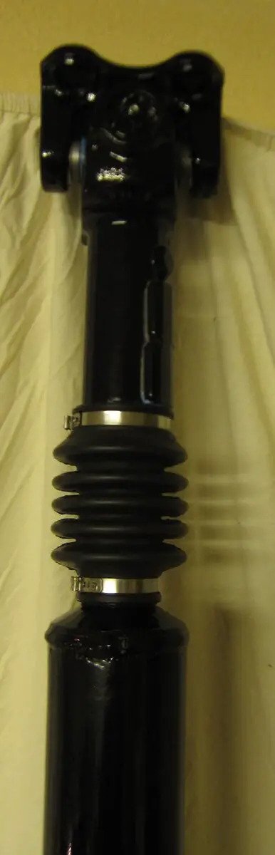

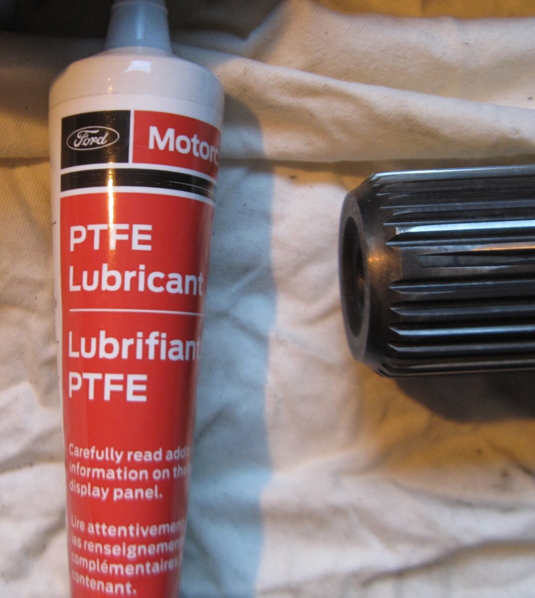

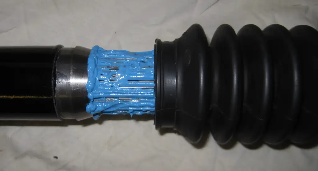

So everything is back together with Spicer 5-1330-1X U-joints, Spicer 2-7-469 snaprings
and recommended PTFE FORD grease for the slip yoke.
Gave it a glossy paint, so the next spare driveshaft is still waiting for new parts.
Merry Christmas!
Wolfgang
