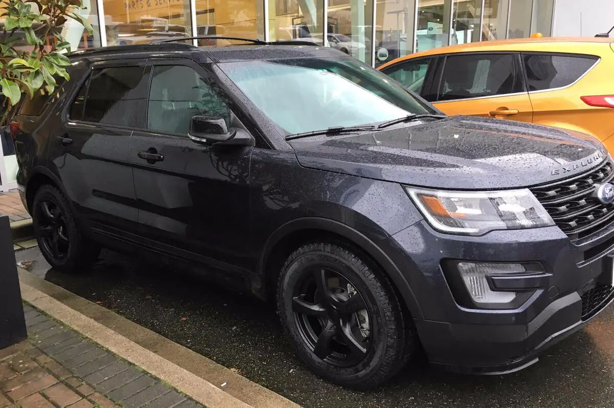

My 2017 Sport is equipped with 245 60R18s. They've been on for almost a month now and believe I was the first 17 Explorer at my local dealer to get winters installed. I ended up buying everything including sensors at different places and getting them installed at Ford.
looks very nice!! Today they are installing 265 60 R18 on my Explorer 2014 so will let you know how it goes. I just bought cheap steel rims but I hope there will be enough clearance as TheFranchise suggested. Will take a pic and post soon. I like the black rims how much did you pay?
Martin
Paid $160 CAD each for them. I like them because they are built for winter with the matte black. Clean and simple. Also covers the lugs which is nice for keeping out the snow and grime.

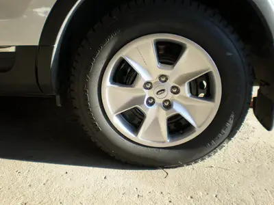

As I mentioned a 235/65R18 will be an exact match and I've been using the 235 for the previous 3 Winters. No issues with grip. I don't know about 'spacers' since I've never used them on the 2011, 2014 or current 2017. Here is what the one on my 2011 looked like c/w Ford wheel cover.

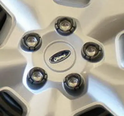

If you decide to go with the wheel cover you will have to get new wheel studs since they hold the cover on and have a flange that holds the cover on (see blow up).
Cool thanks Peter! I shall now go perusing to find the best price on the 235/65R18 :) Won't go Wheel covers as I want to copy @kmarnes look. Below is how they attach then they're finished off with a cover for the lugs.

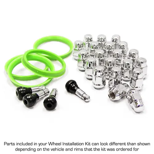

Last thing I need to understand is whether I need these aforementioned plastic spacers and a good place to get them if I do. Kind of want to get them fitted and not have to go back and I don't live too close to any of these places.
At 1010tire you buy the wheel and the tire spacing kit together (or tirerack.com in the US). You can literally get them shipped to a designated dealer close to where you live to get them installed.

annoyingly I bought the wheels separately.. I love to make things hard I guess :) I see them (below) after I added them to my cart in 1010 so i'll try their customer service for dimensions tomorrow when they wake up
