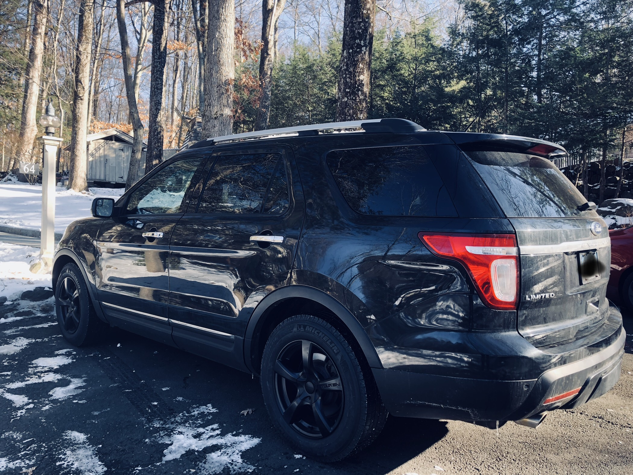

Had mine on for about 3 weeks now, very happy with the wheels / tires, they already got me through some nasty weather well. Bearly notice any difference to the handling so like the 235s. Had some disasters in fitting them - the tire place wouldn’t fit the damn wheels as I didn’t buy it from them (lame) and they failed to check all the TPMS sensors, one had failed but now I’m happy. Thanks for all the help, if anyone else wants the wheels check out eBay - Aspire motoring in LA. Were far cheaper and were very helpful / responsive.
View attachment 154031 Had mine on for about 3 weeks now, very happy with the wheels / tires, they already got me through some nasty weather well. Bearly notice any difference to the handling so like the 235s. Had some disasters in fitting them - the tire place wouldn’t fit the damn wheels as I didn’t buy it from them (lame) and they failed to check all the TPMS sensors, one had failed but now I’m happy. Thanks for all the help, if anyone else wants the wheels check out eBay - Aspire motoring in LA. Were far cheaper and were very helpful / responsive.
Nice wheels! They look familar ;) Just remember if you switch them yourself, don't use power tools on the lug-nug cover. They are plastic and easily break. I cracked one of mine, but it's still fine.
