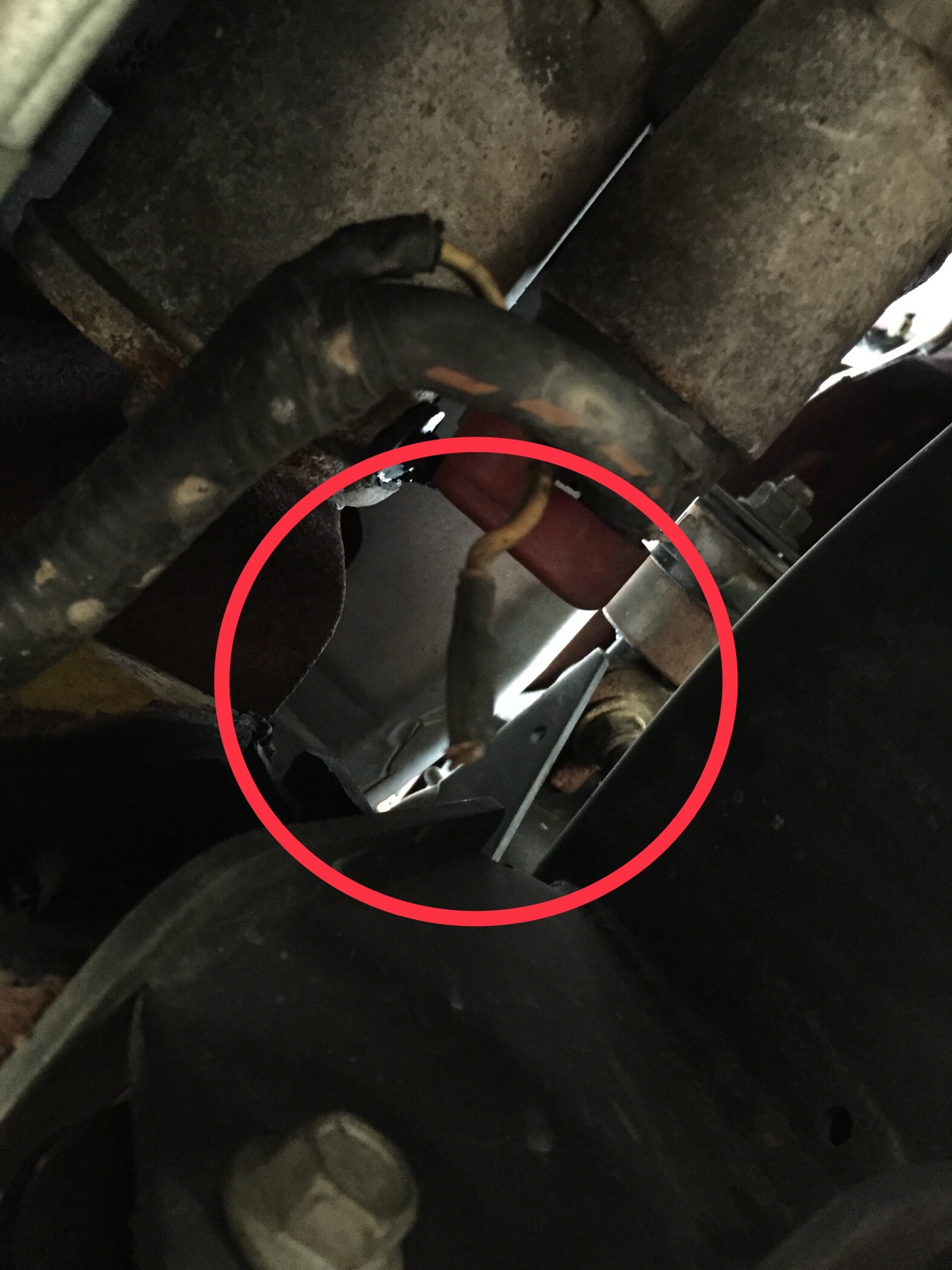

So, stopped at the store the other day, came out and Ex wouldn’t start.
Had wife swing by with new battery, same result.
No evidence of anti theft issue.
Swapped relay with blower relay, same issue.
Test power to starter, big cable has power, little cable no power.
Decide to scrape terminal thinking connection with OHM meter may be bad, and find the small cable moves. Further probing and I find it to be broken at the terminal! WTH?!
Thing is, the connection looked solid from my view. Normally probing at the nut and not the cable.
Now to find a terminal.
