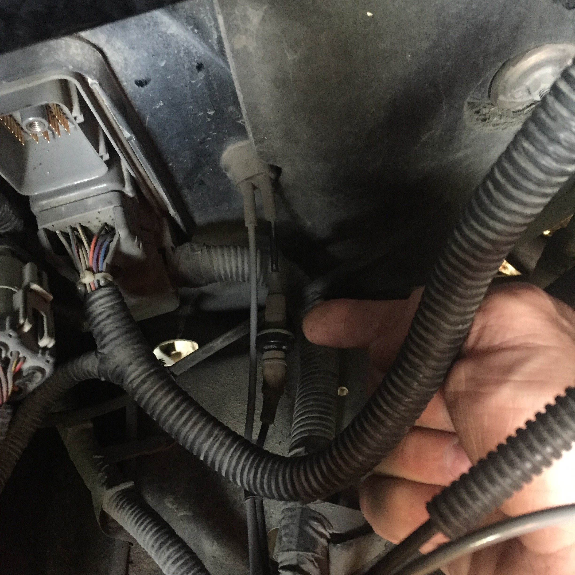

Nope 4.0 has it also, both my rigs have 4.0
Theses hoses are very small look more like wires. Explorers have a gray and black line the gray one goes to a vacuum actuator The other goes to the check Valve then the engine.
Quick photo
Just looked at your Amazon link. I would use it.
^ Good info, thanks AK NIMROD. Casually looked, but couldn't find it on my ST. Too many 4.0L SOHC configurations. LOL
