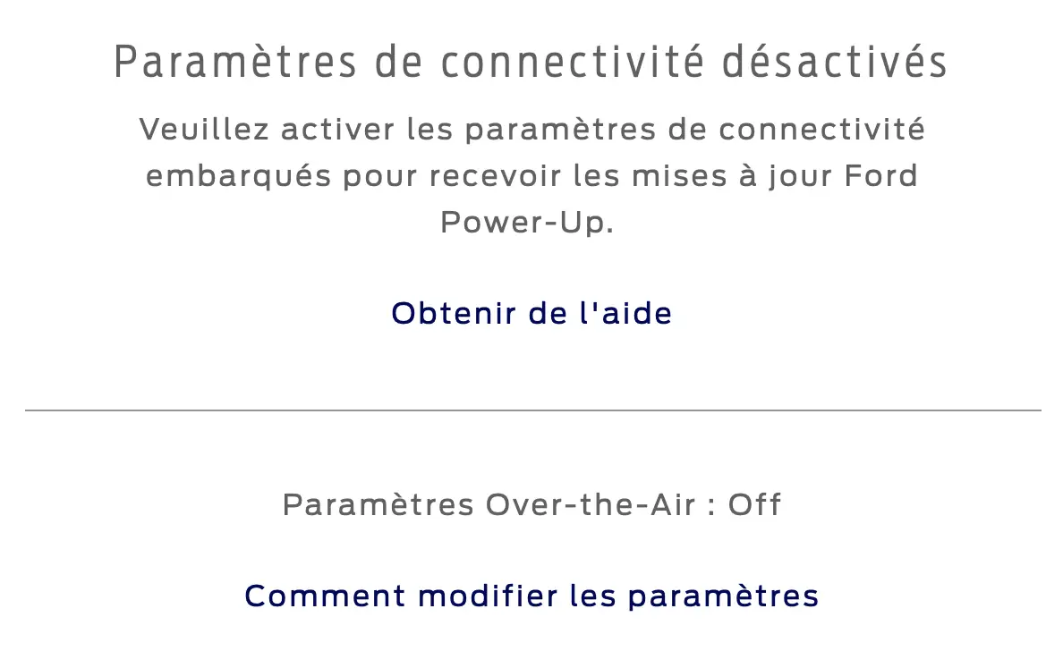

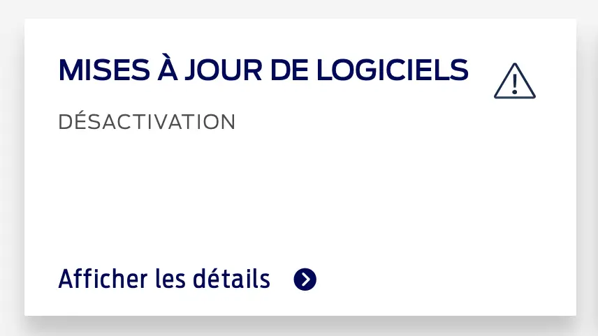

Right now I can't even check the website, because the software updates appear "disabled" (I'm trying to attach a picture):
If I choose "mode details", I am told that the "connectivity parameters are disabled" (2nd picture):
But that's wrong! Connectivity _is_ enabled, and my system _is_ on version 3.4.23188!

I did read somewhere that the Ford website eventually got updated via WiFi. But what puzzles me, is that the site tells me that my "connectivity parameters are disabled" (2nd picture). I'm quite sure that on the car, it's not the case.
Would you think _this_ will also end up fixed automagically? Or is there something I should try on my side (perhaps disable the updates on the car and then re-enable them?)
BR - Daniel

Here's what I did: after disabling the WiFi updates and re-enabling it while the car was in my garage (hence connected to my home WIFi), it sort of unlocked the whole process, and I was able to download the (24 Go) map update from the Ford website.
