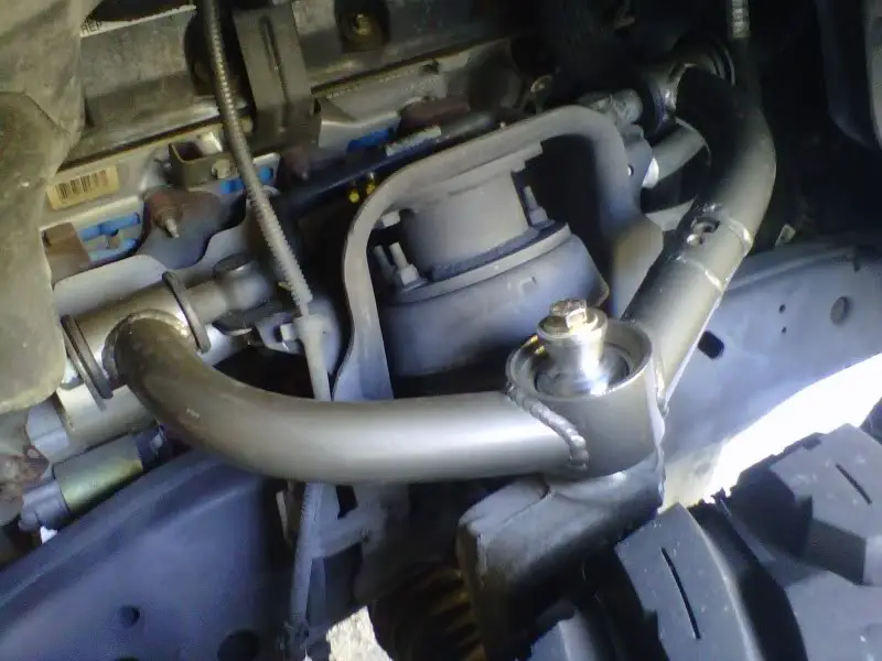

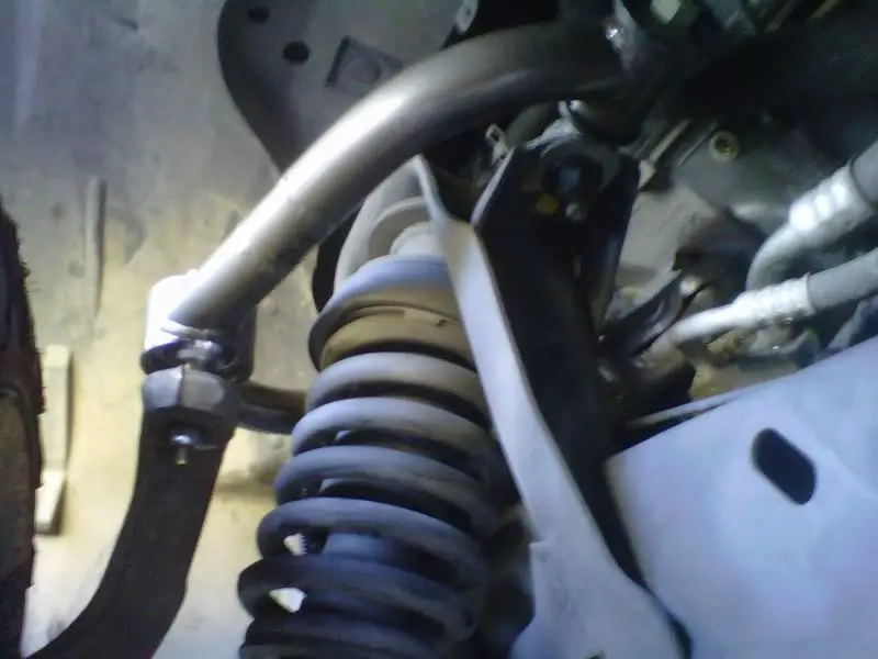

HERE IS THE CURE...
SOO MUCH BETTER
hey dirtball what did brandon do for bushings?
He just replaced them with some new ones. They just slide on. About $20 per side I think he said.
