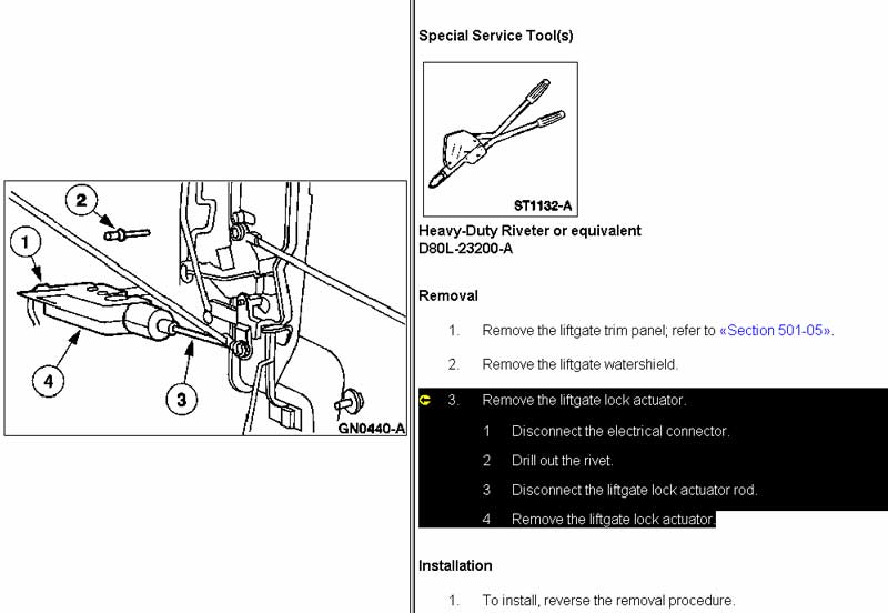

The actuator cost approx $70 from the Ford dealer. I'm guessing they would charge between 1/2 to 1 hour labor to replace it in the rear hatch. I did mine myself. It isn't super difficult, but you have to drill out the rivet that fastens it to the hatch to remove the actuator.
Here is the procedure for replacing the actuator. You can substitute a button head machine screw and a nylon locknut for the heavy duty rivet; that way you don't need the special rivet tool.

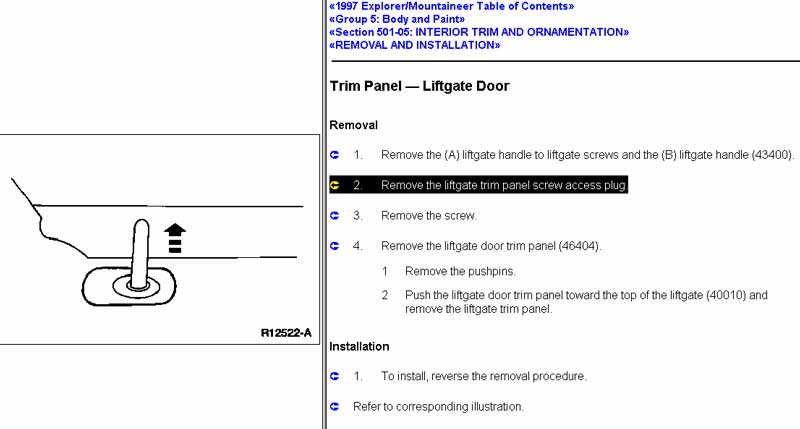

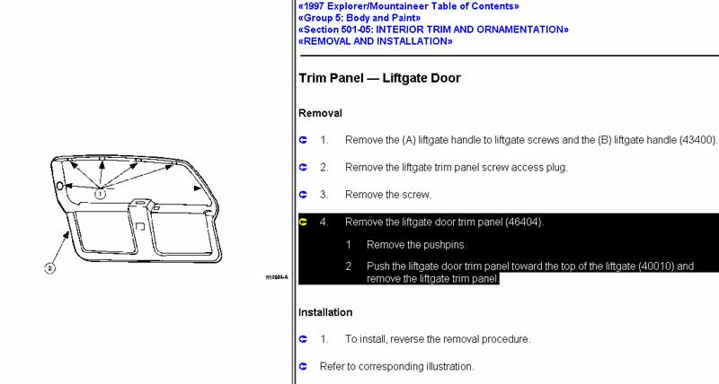

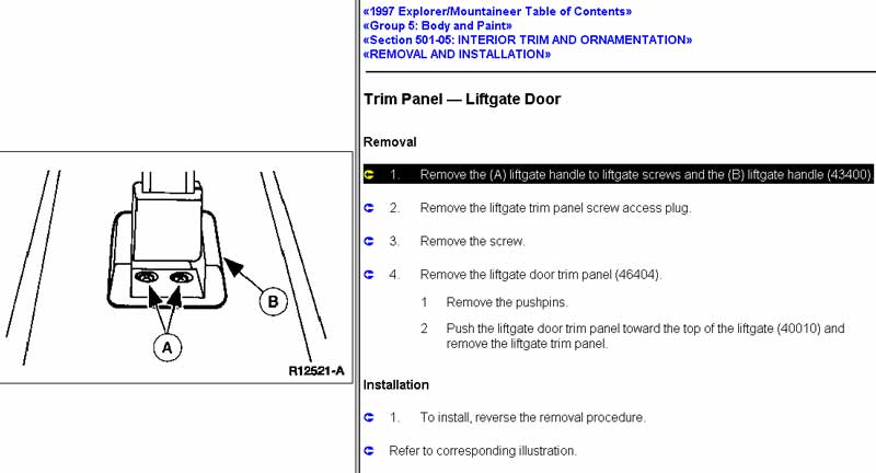

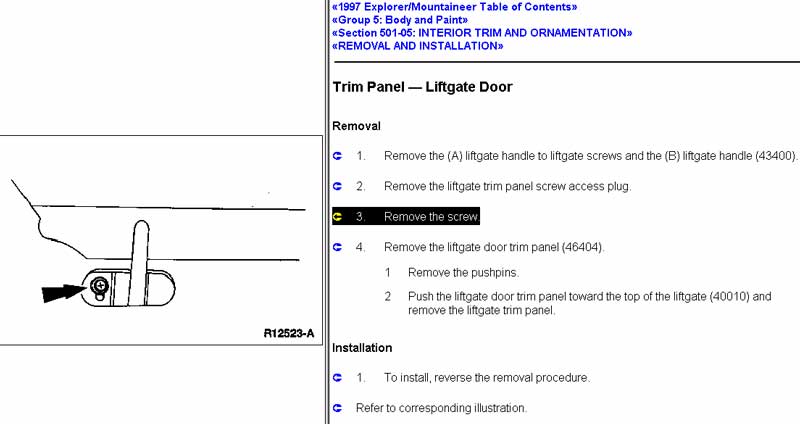

Here is the procedure to remove the trim panel. There are four drawings to show the details:
trim 2
trim 3
trim 4
