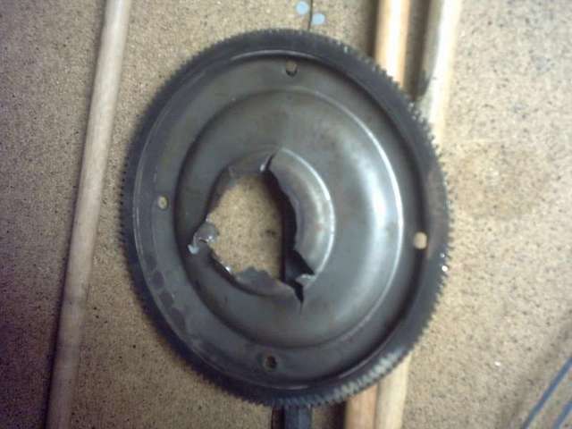

It could be the heat sheild around the catalytic converter. OR it could be the flex plate cracking and exploding.

What is a Flex Plate and where is it located?
Thanks again for your help.
hahahaha, flex pate is the flywheel, between engine and transmission, bolts to torque convertor,thats what pictured above.
