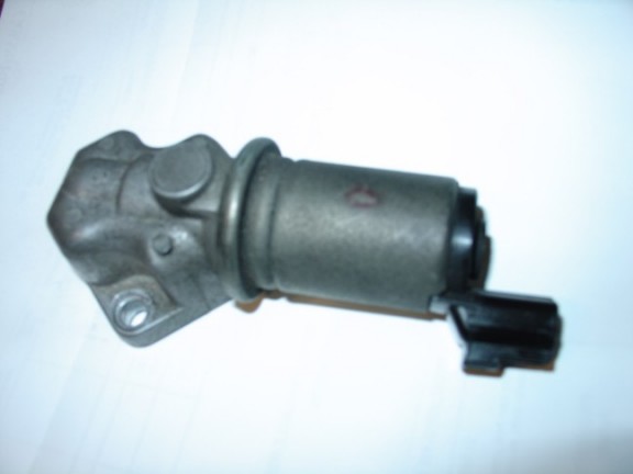

Does your IAC look like this? Sorry for poor quality pics.
I had the same problem. Most Part stores have two IAC valves listed for 95 and 96 X's. I finally had to take mine off and show it to the people to get the right one. Mine looks like the one pictured above. But the one I kept getting had the connector facing a different way.

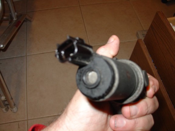

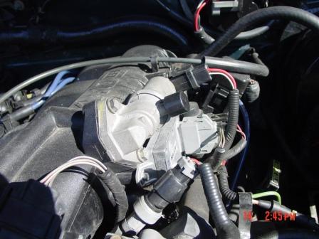

here is what is it looking like
hope they come out good as it was very sunny today
of course this is similar to what i keep getting..
thanks to karl_burns for the picture of his IAC
