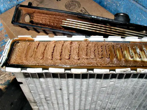

You said you got the system drained. How did you drain it? Pull the lower rad hose? If you did it that way, what was the flow out of the lower connection on the rad like? Slow, fast? I very rarely will use the drain plug to drain them because they get filled up with crap really easily. Also, before you go and spend a bunch of time trying to flush a potentially plugged rad, what does the epoxy that joins the tubes to the tank header look like? If it has cracks, or is separating don't even bother trying anything. Just toss it out and get a new one.
EDIT: Sometimes the rad will look ok at the top (looking in filler neck), but near the bottom it will look like this:
Make sure you do a flow test so you're not wasting your time.
How do I pull apart the rad like the image? I pulled it and sprayed off the gunk on the outside.
You don't want to do it, we have a poster here who used to work in a radiator shop, and even with the special tools designed to "reclamp" those tabs it would mostly never not leak afterwards....

I've done this before. Why did I do it? Because someone gave me $15 for a used radiator which I didn't have a good one for the truck they wanted it for. So I poped the ends off of a good one and put the correct ends on it. I just talked to her about it a few days ago and she said it still doesn't leak. It's been several years.
But then again I've never seen one look as bad as the picture above before. It can be done with regular shop tools fairly easily but I don't recommend doing it. I told her I switched the ends on it so it would work in her S-10 and that it may leak a little bit. She didn't care because it was only $15 Vs. having to pay over $100 locally for a new one.
Recrimping these rads is hit and miss. The proper way requires a rack to hold the rad and a special crimping tool. I know of people using channel lock pliers to recrimp them, but that too is hit and miss. The pic wasn't to give you the idea of pulling the tanks off, but just to show you what it can look like. The rad in the pic failed because of Dexcool coolant being absolute garbage (it's a GM thing). If you think your rad may be plugged, do a flow test. Remove it from the truck, stand it on end with the lower connection to the ground and plug the lower connection. Then fill it with water. Once it's full, pull the plug and see how quickly it drains, it should only take a few seconds. If it's plugged, it should be fairly obvious.
