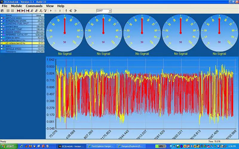

I have recently started using the SCT Live Link software with my new laptop to see how the engine is running as I change the tune with the Pro Racer software.
Recently while monitoring the O2 sensor voltages for bank 1 & 2 I noted that bank 1's voltage readings were constantly fluctuating from .06v to .845v so frequently that on a chart it apears almost as a solid color. Bank 2 looks good and responds to throttle and load as expected.
Any ideas of what might cause this type of fluctuation? Where do I begin trouble shooting? These O2 sensors are new Bosch changed 5 months ago

Note the red line is bank 1 front while the yellow is bank 2 front.

Sorry the original message did not include the image. From what I understand about how O2 sensors are supposed to work, the yellow line (bank 2 front) is not working properly.

It doesn't look like it's switching like it should if that's the front one. However, I know somewhere ellse there was a post about someone having a odd 02 sensor reading, and when they contacted Bama Chips - they said it was bc of the tune. You might want to research that.

That is the from O2 sensor labled as bank 2 front, the bank 1 front (The red trace) looks like it is swithching correctly. Of the 4 O2 sensors that one ( the yellow line) is the only one with that problem.

I finally figured out the problem today. While troubleshooting this problem, I had replaced the o2 sensor twice with Bosch sensors purchased at Auto Zone a local car parts store.
Apparantley the 03 Ford Explorer uses 2 types of sensors, a 3.3 ohm and a 6 ohm heater coil type. The 3.3 ohm ones are used in the front or upstream positions while the 6 ohm ones are used after the cats. Auto Zone apprantly did not know this.
In Fords service DVD manual the reason given for this is so that the front sensors can heat up faster (as the 3.3 ohm heater will draw roughly twice the current of the 6 ohm heater) to enable the engine to enter the closed loop mode sooner.
After swithching out the sensor with the correct model it ran fine.
