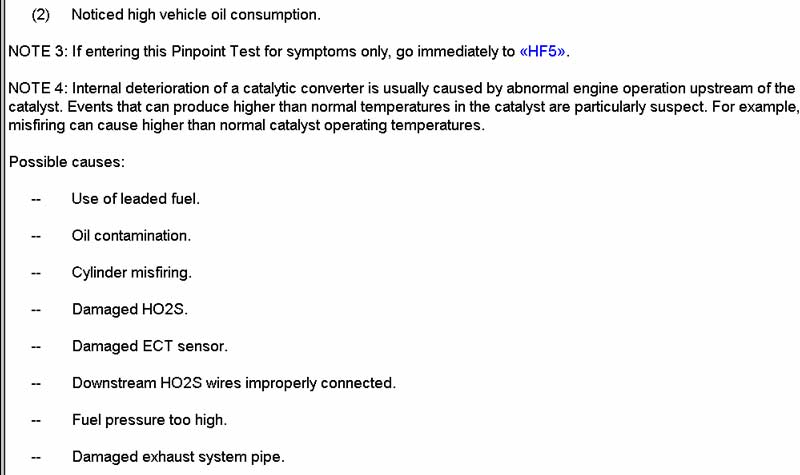

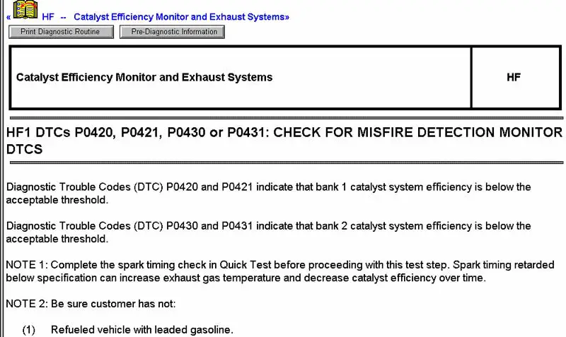

hey guys, i got a CEL the other day and hasnt went off. i bought a cheap scan tool at walmart (one i bought and returned while ago cause it didnt work on my moms 95 lol) anyway i got the code P0420. cleared it and here i am now. i looked in the book to find this: P0420 Catalyst System Efficiency Below Threshold (Bank 1). what does this mean? i have been looking for a while and can just find that. what would be wrong?
