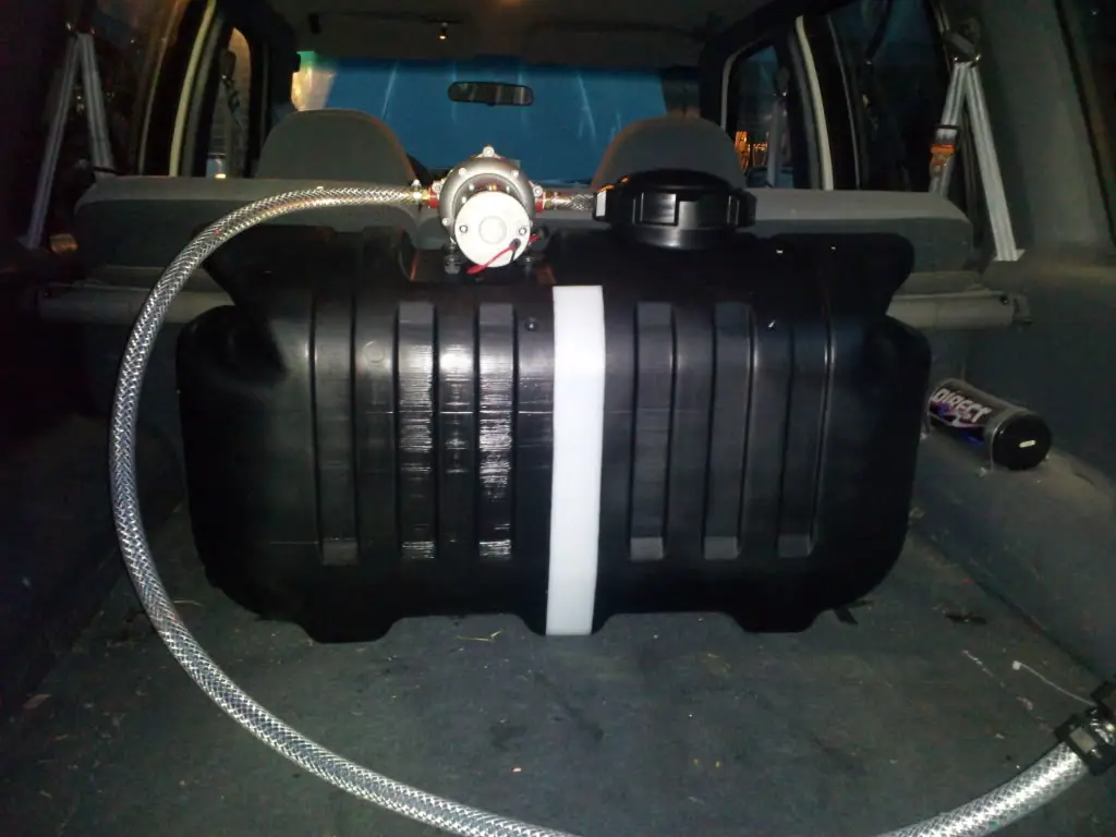

The one im looking at is at northern tool,thats where i got the tank from.they have kany models.2.2-3-4-5.5gpm all run at 60psi and have the pressure switch built in.i went by again today and im kindof lost.i know i need atleast a 2.0gpm but say on the 2.2gpm pump,would that be maxing the pump out making it run harder? I was leaning towards the 5.5gpm so that the pump doesnt have to run hard to make 2.0gpm.or you think thats just over kill?think i would like to have atleast double in case and its only $20 more dollars for the 5.5 compared to the 4.0.ps the tank was $49 for 26gallon and the 5.5 pump is $120
well im all done.came out pretty good i think:D:Di went with the 4.0gpm at 60psi.the shower runs great and so does just a regular hose sprayer,PLENTY of pressure.i also put a male end quick disconnect on the end that is inside the tank.that way i can hook my 50ft coil hose to it(inlet of pump) and run it down in the river,then put the other end(outlet of pump) into the tank.that way it will suck river water in and fill its self.;)
solved my water heater issue,i dont know why i didnt think of this earlier.just going to drill a hole and mount a 1000watt water heater element into it.it shouldn't take long at all to heat it up given that it probably be 80+ anyways to start with:D
http://www.amazon.com/Camco-02103-1000w-Heater-Element/dp/B0006IX8AA
well turns out that element wont work.ill end up getting this but for now i have something that will work.
http://www.amazon.com/MARSHALLTOWN-Premier-742G-Bucket-Heater/dp/B000BDB4UG
well just a update.went on my trip last weekend and the obw worked great;)took a shower both nights.the heating element i was using took awile to heat it but worked,shower was so hot it was steaming.hahha never thought i would take a mountain spring hot shower on the side of a mountain.had plenty of water,took a really long shower and washed some pots/pans and only used about a 1/3 of the water.i did stop on the trail and filled up on shoe creek.
